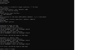

    Dear All
    We are using a simulation of A9 core based on Cadence Palladium, its identical to working with an actual A9 core except for speed.
    When connecting using 642d, the connection fails. See attached image for details.
    However
    When connecting using 500i, connection is successful . See attached image.
    Can you think of a reason for the different behavior between the version.
    Thanks

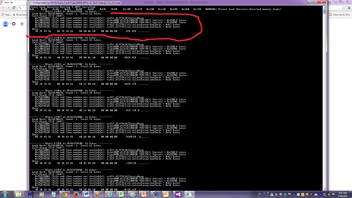

    Hello Eric,
    we left this issue for quiet a while, but returned in an attempt to solve it once and for all. I'ts killing us!
    I made some progress in isolating the problem, attached please find a zip containing a visual studio 2012 solution (ARM9_IFD.sln) which reproduces it.
    The solution contains two projects:
    *) ARM9_IFD - generates a ARM9_IFD.dll, a dll based on your SDK with two functions - core_open and core_close, which activate JLINKARM_Open() and JLINKARM_Close()
    *) Jlink_test - a main program (executable) which loads the library ARM9_IFD, gets the processes for core_open and core_close that performs open and close using the DLL. The executable performs a loop of 0x300 calls to core_open and core_close.
    After several iteration we get a windows error message (see win_error.jpeg) or access violation.
    If I replace the call to ARM9_IFD.dll core_open and instead call JLINKARM_Open() from my executable (main.cpp line 56 which is commented out), there is no corruption.
    This hints that perhaps the problem occurs only when using JLink SDK thru a DLL.
    I executed the test with "Visual Leak Detector", which resulted in a terrible memory corruption (see vld_dump.jpg) and an endless dump of error messages.
    Version in use:
    JLinkArm.dll is taken from version 500i
    JLink SDK is version 462
    Please contact me about details on how to execute the test it it is not clear enough.
    Many Thanks!
    Hila
