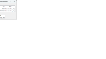

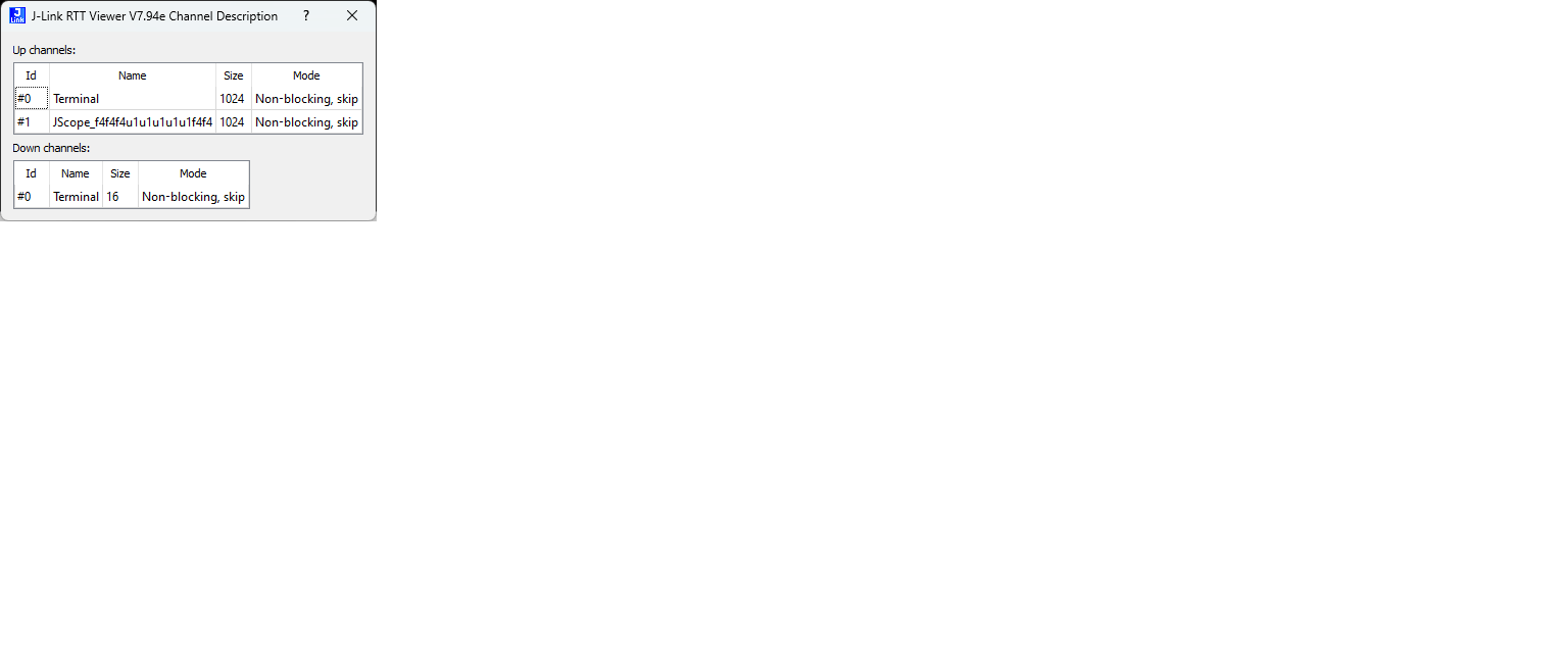

    Because JScope HSS sampling is currently not working for me (see forum.segger.com/index.php/Thr…Failed-to-initialize-HSS/), I'm trying to get JScope working using RTT mode.
    I've configured an up buffer and write data to it. The RTT viewer can find the control block almost immediately and shows the additional channel:
    [img='blob:https://forum.segger.com/81c4fa6a-226e-46b0-9b06-e56dc2b199cf',none,401][/img]
    But when I then start JScope it tries to find the control block for a while and then bails out with the message that the control block can not be found.
    Did I configure something wrong?
    Thanks in advance.
    Kind regards,
    Remco Poelstra

    I am not able to see your screenshot. Could you please try to re-upload it?
    Simon
    I can not see any possible issues in your picture.
