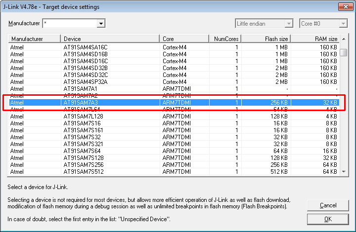

    In EWARM, you specify an RDI DLL to be used for debugging.
    At the loaction of this JLinkRDI.dll there should be a Default.jlinksettings
    Delete this file.
    Start IAR EWARM
    Make sure that IAR flashloader is disabled:
    Start a debug session.
    You should see the following dialog popping up:
    Select the SAM7A3
    Done.

  • Thank you for letting me know what to change to get the example project to work. I knew it had to be something simple.
    When I started the example project, I got the "RDI_SelectDevice" screen you posted earlier. I selected the SAM7A3, the program loaded onto my target and single stepping, breakpoints, etc. appear to be working properly.
    When I load my real project again, I don't get any error messages, nor the "RDI_SelectDevice" screen. I can start the debugger, but it doesn't work since the target still seems to have the example code.
