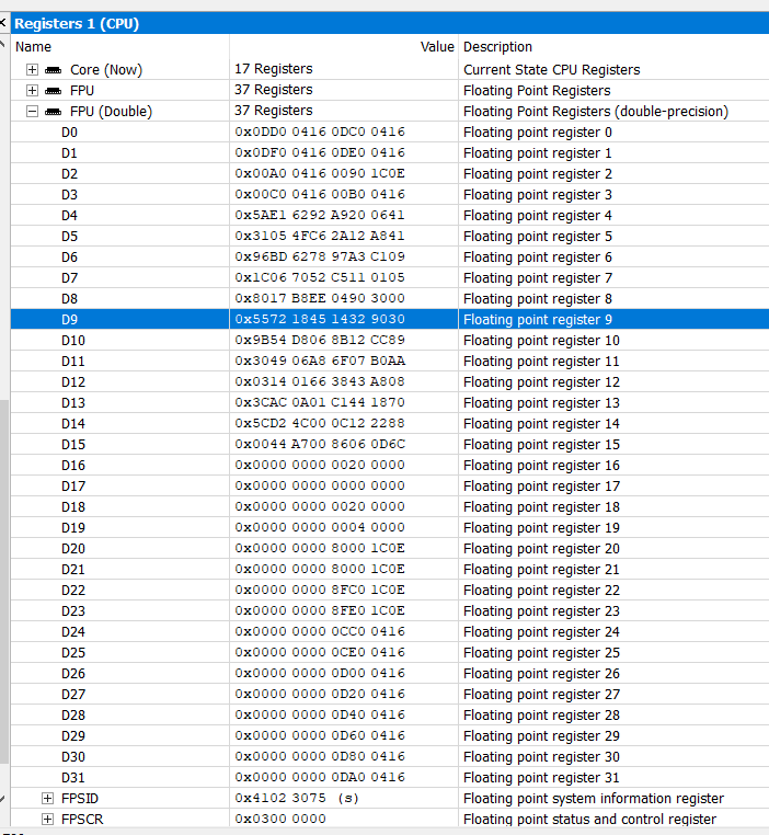

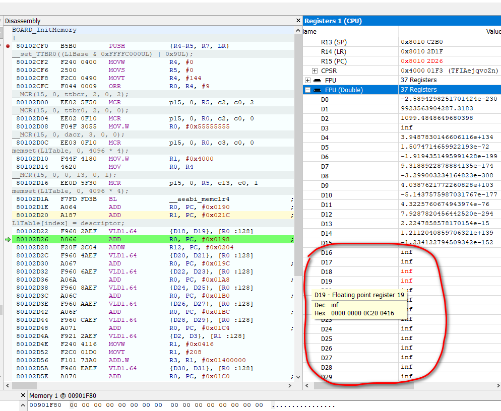

    Using latest Ozone (v3.38a) debugging .elf application for IMX6ULL (Cortex-A7), the second part of double precision registers (D16 to D31) are displayed incorrectly:
    It seems only lower 32 bits of the double register is intact, but high 32 bits are zeroed out for some reason.
    This is user interface only issue, registers contents are actually right and CPU execution goes as intended.
    In the J-Link web control panel these registers are fine with full 64 bit data:
    In IAR EW debugger all is fine also - double precision registers D0-D31 are displayed and edited OK.
    Regards, Vlad.

    Which SVD file are you using? Is it `Cortex-A7.svd` that is coming with Ozone? Are you able to reproduce the issue on an eval board? If so: which one? Could you please provide a J-Link log recorded during a debug session where the issue is reproduced? The register window should show, a in your screenshot, both some registers where the display is correct (i.e. D0..D15) as well as registers where the display is incorrect (i.e. D16..D31). Could you also please provide a screenshot where the register content is displayed as hex value?

    Which is strange - in the log the D registers are seems to read fine in full 64 bits (and D29 is named as D39 for some reason):
    And the screenshots:
    PS: attached board initialization script, in case it might be helpful.

    thank you for providing the details. It appears to be the case that Ozone somehow swallows the upper 32 bits of the registers D16..D31.
    We will need to have a closer look for reproducing the issue locally.
    -- AlexD
  • Hi Vlad,
    we are able to reproduce the issue. A fix will be provided in a future Ozone release.
    Thanks for notifying us!
    -- AlexD
