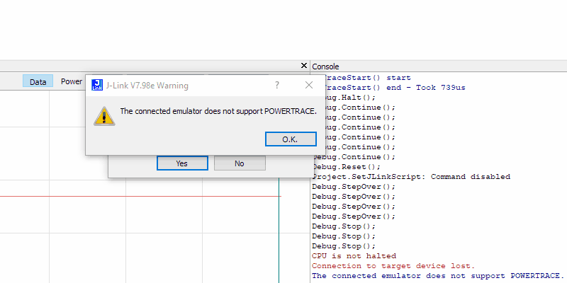

    Playing around with tracebuffer and a J-Link Edu V11 I noticed two things. Both happen when power sampling is enabled.
    If you choose to not support power sampling for J-Link Edu/Base/Plus, please at least make in a way it is not disturbing normal operation (or just allow it with a limited sampling rate)
    And yes, I know (now) if I set sampling to “off”, it “solves” this problem. But since I didn't turn it on, or even use the power pane, this was not the first thing that came to mind.
    1. I cannot zoom into the code timeline, y-axis x-axis keeps getting reset
    2. if the connection is lost, waring messages pop up as long as the session is not stopped.

    Not sure why SystemView should be too much overhead. In general it is recommended the tools that fit a given task best. In the case you describe, SystemView appears to be a very good solution.
    I just tried: Zooming on the Y-axis of the code pane works as a charm using shift-mouse wheel. I cannot reproduce the issue you observe, but I also cannot see that you are doing zooming in the Y-axis in your screen recording.
    Power sampling is disabled in the power sampling window. Disabling the power pane in the timeline window just hides the data but does not disable it. The same is true for instruction tracing and data sampling.
    I was also not able to reproduce the issue you describe in bullet 2. Could you please explain in detail how that can be done?

    Reproduce 2:
    • (I cannot reproduce on my work-PC right now)
    • Start debug session with J-Link Edu
    • Enable power sampling (if not already enabled)
    • Disconnect J-Link USB cable (or some other reason USB connection ist lost, e.g. a disturbance)

  • Hi fraengers,
    we were able to reproduce the issues from bullet point #1 and #2. We will provide fixes in a future release of Ozone.
