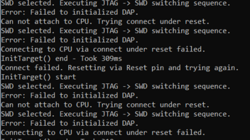

  • Hello, I have JLink Ultra+ and STM32 Nucleo-G474RE. When I try to connect I am having this error.
    Debug.Start();
    Device "STM32G474RE" selected.
    InitTarget() start
    SWD selected. Executing JTAG -> SWD switching sequence.
    Error: Failed to initialized DAP.
    Can not attach to CPU. Trying connect under reset.
    Connecting to CPU via connect under reset failed.
    InitTarget() end - Took 306ms
    Connect failed. Resetting via Reset pin and trying again.
    InitTarget() start
    InitTarget() end - Took 307ms
    InitTarget() start
    InitTarget() end - Took 305ms
    InitTarget() start

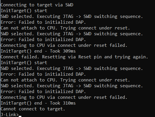

    Then I tried with J-Link Commander and seeing same error. How can I fix that? Thanks.
    Ali
