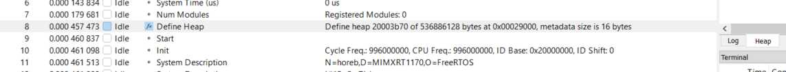

Hi all, right now I'm using SystemView to monitoring the heap usage of RT1176 MCU.
I would like to have two clarifications about the heap define message because there's something not so clear for me.
As you can see in the attachment, the message I got is the following:
Define heap 20003b70 of 536886128 at 0x00029000, metadata size is 16 bytes
where in the code, I called this function
SEGGER_SYSVIEW_HeapDefine(tlsf, work_mem_int, sizeof(work_mem_int), 16);
where
- 0x20003b70 is the address of the heap memory (work_mem_int), also confirmed by using Ozone debugger
- 0x29000 is the heap size (164KB), also confirmed by using Ozone debugger
I have two questions:
1) what's the number 536886128 got from the heap define message? Seems to be the overall size of SDRAM memory -> 512MB which is correct: the NXP EVK has two 256 MB, 200 MHz SDRAM (W9825G6KH-5I) is used on the EVK Board.
How can SystemView read this value? I haven't set this in the SystemView API. Just for my understanding.
2) I think that the message above should be :
Define heap 29000 of 536886128 at 0x20003b70, metadata size is 16 bytes.
it seems that 20003b70 and 29000 are swapped? is it correct?
many thanks!
