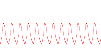

When I joined the lines using the draw function in emWin, I noticed that there were some small spikes at the joints, as shown in the figure. Is there any way I can eliminate them? Does the GUI_DrawGraph interface in the manual allow you to change the size of a line?
When drawing lines with GUI_Draw_AA_Line, spikes appear at the joints
This is most likely because the lines do overlap each other. Unfortunately, there is no way to avoid it.
You might try the SPLINE drawing operations:
https://www.segger.com/doc/UM03001_em…Drawing_splines
https://wiki.segger.com/Spline_(Sample)Regards,
Sven -
After trying to draw with SPLINE, the waveform data obtained is still not very satisfactory. This is a rendering using SPLINE. Is there any way I can eliminate the jagged center?
