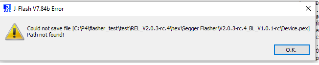

    In case of saving the cfg file with the following name I get an error:
    TEST_TEST_V1.0.3-rc.4_BL_V1.0.1-rc.2.cfg
    "Could not save file [C:\Users...\TEST_TEST_V1.0.3-rc.4_BL_V1.0.1-rc\Device.pex] Path not found!"
    In case of using underlined instead of dots everything is ok:
    TEST_TEST_V1_0_3-rc_4_BL_V1_0_1-rc_2.cfg
    It seems that there is a problem with path / dots / ...
    Thank you in advance.

  • Hi Fabian,
    here is the step by step procedure, hopefully you can reproduce it on your side (done with V7.84.b).
    The *.jflash file is located here:
    "C:\P4\flasher_test\test\REL_V2.0.3-rc.4\hex\Segger Flasher\STM32L071RB.jflash"
    The data file is located in the parent folder:
    "C:\P4\flasher_test\test\REL_V2.0.3-rc.4\hex\V2.0.3-rc.4_BL_V1.0.1-rc.2.hex"
    By trying to save the config-file via "File->Save Config Flasher File" to the following folder:
    "C:\P4\flasher_test\test\REL_V2.0.3-rc.4\hex\Segger Flasher\V2.0.3-rc.4_BL_V1.0.1-rc.2.cfg"
    I'm getting this Error:
    "Could not save file [C:\P4\flasher_test\test\REL_V2.0.3-rc.4\hex\Segger Flasher\V2.03-rc.4_BL_V1.0.1-rc\Device.pex] Path not found"
    Marco
  • Hi Marco,
    we were able to recreate the issue and fixed it internally.
    A fix will be part of the next J-Link Software version, planned for some time next week.
    Thank you for making this issue known to us.
    We are sorry for any inconvenience caused.
