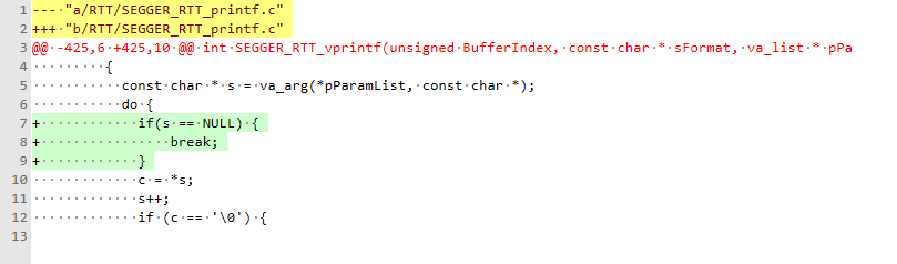

    we're having software that passes printf format strings with %s in the format string, but the corresponding char * is NULL in same cases.
    As it is cumbersome to check the variadic arguments (va_args) values before passing them into SEGGER_RTT_vprintf we do patch the Segger RTT sources with an additional check right now.
    We also created a patch file: null_string_va_arg.zip
    It would be nice, if this patch could get part of the official RTT release.

    Patch would then look something like that:
    Code: SEGGER_RTT_printf.c
    if(s == NULL) {
                    _StoreChar(&BufferDesc, '(');
                    _StoreChar(&BufferDesc, 'n');
                    _StoreChar(&BufferDesc, 'u');
                    _StoreChar(&BufferDesc, 'l');
                    _StoreChar(&BufferDesc, ')');
                    break;
    which is also totally ok :thumbup:

    We agree that a crash should be avoided here.
    We will add a "NULL" (or similar) return message at some point in the future.

    this was officially added with the release of J-Link Software Version V7.92i.
    Excerpt from the release notes:
    Code
    SEGGER_RTT_vprintf(): %s handling: In case string is NULL-pointer, function will now write "(NULL)" instead of doing a NULL-pointer access.
