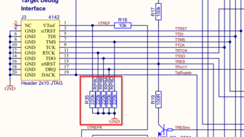

    Back story:
    We are using 2 lines for UART(5 and 17 as mentioned in your wiki for UART) and for other purposes and we suspected these lines are being pulled by Jlink.
    We are trying to run acclerometer test before initial uart (before enabling uart) which share the same pin on our custom board.
    The test failed, but when disconnect the line that connect to pin 5 in jlink (plus) , acc test pass.
    Any suggestions ?
    Ben

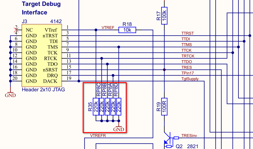

  • Can you please send the S/N of your J-Link?
    We can then provide more detailed information about the circuit.
    Please find attached an excerpt from the schematics which shows the pull-downs on the debug lines.
    These are not configurable and should not be needed to be.
    The debug signals then go further to 74LVC1T45GW buffers to allow 1.2V - 5V target interface voltages.
    Pin 5 == TDI == Used as UART_Tx when using VCOM functionality.
    This pin will be configured as output if VCOM is enabled on J-Link, so it is actively driven by J-Link.
