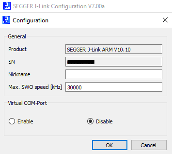

    With the latest version of the Software and Documentation pack, you can find the option here:
    Right-click the J-Link > Select "Configure" > Select "CMSIS-DAP" as boot mode.
  • Hi everyone,
    You would need a J-Link of the latest generation to make use of this feature.
    I forwarded this to our web team so they add this information to the website.
