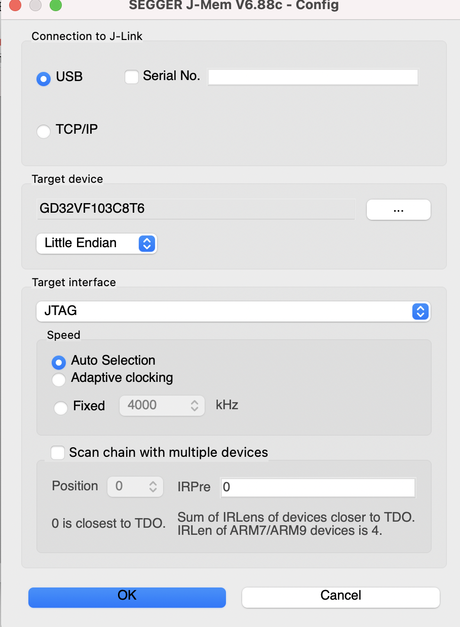

    In a dialogue, action buttons are always on the far right (e.g. "Ok" or "Save") with the dismissive option to the left of that ("Cancel") and anything else ("Reset") to the left of that. If you assign the correct actions to the button roles in QDialogButtonBox, Qt will even do this for you. For example, this dialogue will go against a Mac user's reflexes:
    Your Application.icons have a 72dpi resolution. Any computer that a developer should be using these days has a resolution of >200dpi. In the doc and in the switcher, your icons are blurry. Doesn't this "K" make you sad? Please provide modern assets in Resources/Application.icns
    Most of the vertical centering in everything from buttons to drop-downs is just wrong. This makes all the buttons unsightly (See "OK" and "Cancel" above) and makes some of the text chopped off. I actually recognize this as a bug in QT itself from around 4.6 or so, but that was fixed a long, long time ago. Maybe you have an old version hanging around.

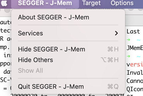

    Also, your menu ordering gets some of the Qt conventions right, but settings are often squirrelly:
    Instead of having another menu entry for "Options", this should be the second entry here, under the label "Preferences" and with a shortcut of a cmd+, Again, Qt should largely handle this for you if you mark the items up correctly. See https://doc.qt.io/qt-5/qmenubar.…global-menu-bar.

    Dialog buttons:
    I understand your concern and we are already aware of this.
    Please understand that the button position (and other GUI layout) is the way it is due to historical reasons.
    In the past, the J-Link software package was only available for Windows, which is why the "Cancel" button is to the right of the "OK" button.
    We try to keep the GUI of the J-Link software as similar as possible, regardless of platform.
    That way our customers can switch between Windows, macOS and Linux without having to readjust to a different layout or similar.
    Due to that, it is possible (and sometimes intended) that some J-Link software GUI layout may not match cosmetic guidelines of the platform it runs on.

    Misaligned text in buttons and dropdown menus:
    Thank you for bringing this to our attention.
    We will check how we can improve this behavior.
