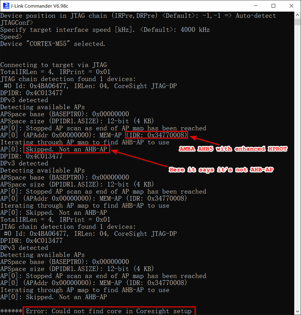

Hello :

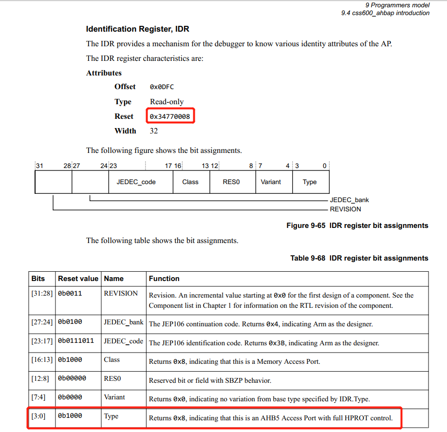

I used jlink v11 to connect cortex-m55. Since the AP IDR value is the latest arm IDR: 0x34770008, the jlink software did not recognize this type and thought it was not AHB-AP, so an error was reported later. Attached are my test log and related screenshots, as well as the official arm's explanation about this IDR. Please help confirm whether this is a jlink bug or jlink does not support cortex-m55?

Arm official documents and jlink log
JLinkLogOverride.log -
The official document of arm is too large to upload
file list:
coresight_soc600_technical_reference_manual_100806_0401_00_en.pdf
debug_interface_v6_0_architecture_specification_IHI0074C.pdf -

hello ErikToday I tested the v7.00 version of the software, and the bug I raised has been resolved in this version, thank you
Good to hear that you are up and running again.As the issue was resolved, we will close this thread now.
