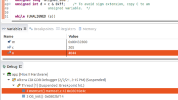

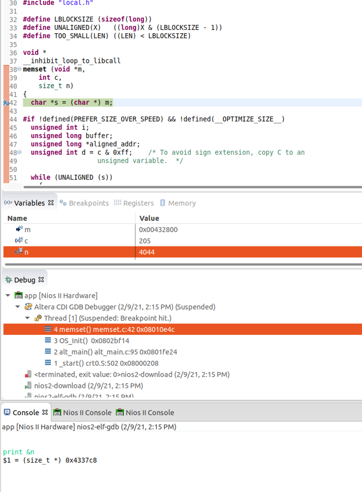

  • Hi there - I'm currently evaluating embOS for use on a custom board. The board's main IC is a Intel MAX10 FPGA with a Nios2 soft core. I can get embOS to run (to an extent....) with certain BSP configurations and not for others. The most noticeable issue is when I deselect 'enable small c library' (in other words, when I'm using the large c library) in the BSP, then OS_Init() never exits. After debugging, I see that OS_Init() calls memset() to initialize the system stack - but a this contains an overflow error: memset() overwrites adjacent memory - the most obvious of which is the 3rd parameter of memset (size) which then causes memset to run indefinitely. Changing the size of the system stack doesn't change this behaviour.
    In the attached screenshot, you can see what's going on a bit more clearly: memset is called with a start address of 0x432800 (m) and a size of 4044 bytes (n). However, as you can see from the gdb output, the address of n is 0x4337c8 which means its going to get overwritten as the end of the block that memset is working with is 0x4337cc.
