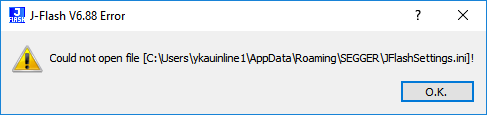

    I am using J-Flash V6.88 and J-Flash SPI V6.88 with 4 JLink Pluses to program multiple targets simultaneously. From time to time I get a pop-up message with error: Could not open file [C:\Users\...\Appdata\Roaming\SEGGER\JFlashSettings.ini]! or Could not open file [C:\Users\...\Appdata\Roaming\SEGGER\JFlashSPI.ini]!
    After closing this error message, the programming continues normally.

    Thank you for your report.
    I was able to reproduce the issue that you described.
    We are working on a fix for this right now.
    I will get back to you ASAP.
    we have determined the root cause of the unexpected behavior that you described.
    The issue has been fixed internally already.
    The fix will be part of the next version of the J-Link software package, planned to be released later today.
    Sorry for any inconveniences caused by this.
    Thank you for bringing this to our attention.
