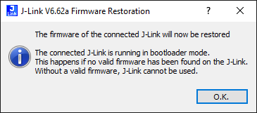

    We have a problem with a J-Link Plus that we bought last year. Part number is 8.08.28, version is 10.1.
    Our problem is that the J-Link firmware fails to boot, so it falls back to a bootloader firmware that won't even accept USB connections, making it functionally useless. The only reaction we can get out of it is the first time we try to establish a connection with J-Link Commander, it'll detect that we need to update the firmware

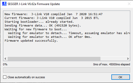

    then the update seems to complete correctly

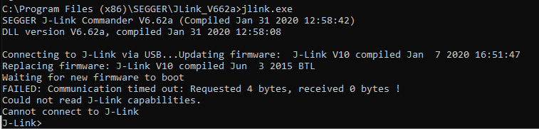

    but the new firmware fails to boot with the following message.
    Here are some text dumps of the logs found in the above pictures (for search discoverability and easy copying) :
    After this failed update cycle, the J-Link won't respond to anything, it just gets stuck on "Connecting to J-Link via USB...", which doesn't timeout even after a whole hour. When the J-Link is in this state, here is what the ShowEmuList command gives us:
    Of course, our actual serial number isn't 123456. If we unplug it and plug it back in, we're back on square one: needs to update, "successfully" updates, doesn't work.

  • Hi Hugo,
    From what we can see, the J-Link seems to be defective.
    Could you please provide us with the serial number of this J-Link?
    I am asking because the the S/N you have added to your forum profile is from a unit which is out of support and warranty.
