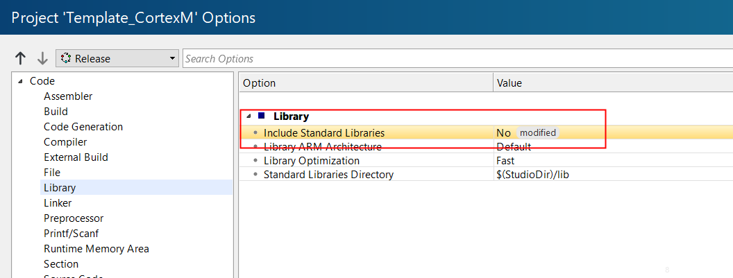

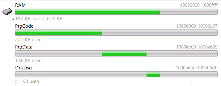

  • hi
    Open_Flashloader has a template projects OpenFlashloader_CortexM_Template_EmbeddedStudio.zip,
    but it has an issue:
    it can not include standard libraries
    I compile project and it has a problem when I add my code into project
    I modify Placement_release.xml below then compile ok and I can get .elf!

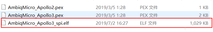

    I put *.elf into C:\Program Files (x86)\SEGGER\JLink_V644d\Devices\AmbiqMicro
    I changed JLinkDevices.xml at C:\Program Files (x86)\SEGGER\JLink_V644d
    I want to use jlink.exe to connect,but "****** Error: Algo error: EraseSector algo function has not been implemented No valid device has been selected."
