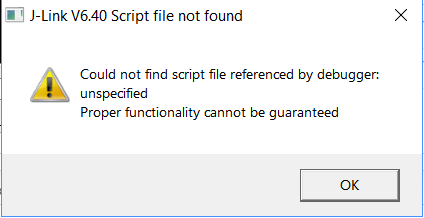

    I am trying to start using command line options like this:
    "C:\Program Files (x86)\SEGGER\JLink_V640\JLinkRTTViewer.exe" –autoconnect -serialnumber 1111111111
    serial number is of course the right one
    my problem is that dialog box appears even when it is suppressed by autoconnect
    when I confirm by OK, another dialog appears with serial number selection, after that last warning message appears as shown here bellow
    how can I connect directly without dialogs?

  • Hello rum,
    I tried reproducing the error you are facing, with no success. The setup you described worked on my end:
    - Connect to J-Link via J-Link commander (you are using a debugger)
    - Start JLinkRTTViewer with "--autoconnect --serialnumber <S/N> --connection sess"
    --> JLinkRTTViewer starts without any additional dialog and attaches to J-Link using the existing session

  • Hello Leon,
    this dialog in attachment… I thing that when "autoconnect" option is used it should no appear?
    before I had on line "script file" = unspecified (which is default setting), as seen in previous post. When you hit OK, appeared warning "scrip not found".
    This is not occurring anymore since I deleted "unspecified".
    rum
  • Hello rum,
    You are correct. That dialog should not appear when using the command line option "--autoconnect".
    The bug regarding an "unspecified" script file has been fixed with the current version of the JLinkRTTViewer.
    Could you please give the current version, V6.42, a try?

  • Hello rum,
    In the command line that you posted, you are using a different symbol than an ASCII minus.
    If you look closely:
    You can see that those symbols are different, which is why they were parsed incorrectly.
    Could you please make sure to only use the standard ASCII minus symbol (0x2D) for command line parameters?
    Here is a corrected version of your command line:
    "C:\Program Files (x86)\SEGGER\JLink_V642\JLinkRTTViewer.exe" --autoconnect --serialnumber <S/N> --connection sess
    Could you please try again with the corrected version and provide feedback?
    Thank you in advance.
  • Hello Leon,
    you have very good sight, I have copied those dashes with words from manual just to be sure because before I was using just one dash.
    now it works, thank you !!!
