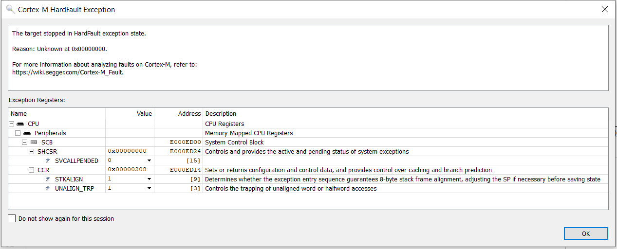

    Short Story (Steps to reproduce):
    - Open blinky example for RP2040-Pico in Segger-Embedded-Studio.
    - Build the project
    - Click "Debug/Debug With Ozone (Alt F5)"
    - When Ozone opens, start debug session
    - Get a Hardfault at 0x00000000 (screenshot is attached)
    This is all done using standard Raspberry Pi Pico Dev-Board, no custom hardware is used yet.

    But after connecting the J-Link to the Pi-Pico (as shown in the Segger Knowledgebase: SWCLK, SWDIO, GND, Vtarget) and loading the elf file into Ozone a Hardfault occured immediatly after starting debugging.

    But as soon as I clicked on Debug with Ozone and started the debug session the Hardfault occured.
    So it seems, that debugging works with SES, but not with Ozone.

  • Hi Martin,
    please have a look at kb.segger.com/Raspberry_Pi_RP2040. There it is stated
    "the RP2040 includes a boot ROM which needs to be executed after reset in order to guarantee proper functionality."
    Please check if the knowledge base article I referred to earlier does help you here.

  • Hi Alex,
    sorry, i had a brain block.
    When you mentioned a bootloader i only thought of a custom one, not of a builtin ROM-Bootloader.
    Of course you were right. In the knowledge base article you linked the "secret" is mentioned at the very bottom.
    For reference, if anybody will stumble about this in the future, i will repeat the important sentence here:
    Simply leave the functions AfterTargetDownload() and AfterTargetReset() empty (but not commented out!).
    This did the trick for me.
