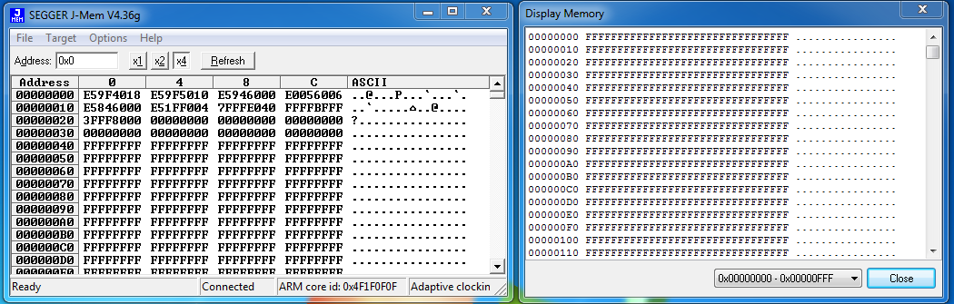

    Hi all,
    I'm unable to write my the internal Flash of my LPC2378 controller. I tried that from JLink Commander with version 4.36g and version 4.34d (see code section below).
    It does not give me any error, but when I read back my controller memory it is still blank. However I'm able to flash my controller via serial cable (ISP) and a cheap Olimex JTAG.
    Do I need an additional license for flash download?

    Did you give the "search" functionality of the forum a chance?
    This is not the first time that this question is asked here. It is also explained in the user manual UM08001 of V4.36g how to use flash download via J-Link Commander:
    Command sequence:
    exec device = LPC2378
    h
    loadbin C:\..., 0
  • I should have been more specific on what I already tried.
    I already tried the procedure you described and which is stated in the manual. In my last setup I enabled the device select override, so it made it look like I forgot about that.
    To be specific, I tried it both with device select override and the method you described.
    I also tried via GDB without luck, and of course I double checked the jumper settings on my board too. It's a Olimex LPC-2378-STK.
    I discovered another strange thing recently, it seems that the reading from JMem and the FlashMagic Tool differ for a fresh erased device (see attached screenshot).
    Edit:
    Easy Explanation of the phenomena, just forgot to pull out the jumpers for the ISP programming. So I guess this was just the signal to stop working for today... :)
