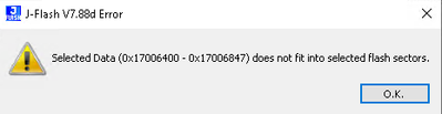

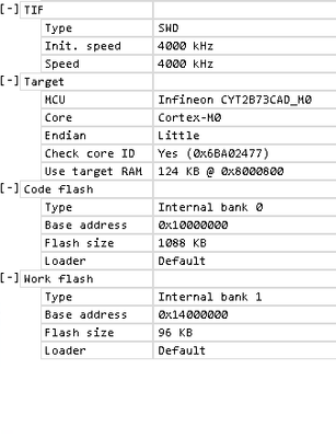

    I'm trying to program Infineon CYT2B73CAD_M0 MCU (TRAVEO-II) with J-Link (SWD) using the J-Flash GUI, however I'm met with an error “Selected data does not fit into selected flash sectors” (see attached image). I believe it could be because of the lack of a "SFlash" region/bank (range: 0x1700_0000 to 0x1700_7FFF) (see attached image as it only shows Code flash and Work flash banks but nothing beyond).

    1) Manually added a flash bank from the GUI; I get the error: “ERROR: Could not find CFI compliant flash device”.
    2) I tried with the following J-Link command string in a J-Link Script that I included in my J-Flash projec
    1. int ConfigTargetSettings(void) {
    2. JLINK_ExecCommand("map region 0x17000000-0x17007FFF N");
    3. return 0;
    4. }
    Unfortunately, even with the above, J-Flash complains with the same error that the “Selected data does not fit into selected flash sectors”.
    (NOTE that I'm able to *read* the memory with J-Link CLI though - see attached image)

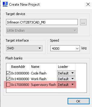

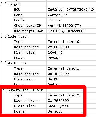

    The problem has been resolved after I updated the J-Flash utility version. We were previously using J-Flash v7.88; after updating to v8.10k (latest), during project creation, we're able to select "Supervisory Flash" bank and able to seamlessly program it directly from J-Flash.
