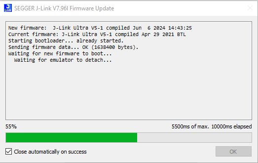

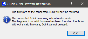

I also had cases, where the debugger (J-link Ultra+ V5.1), lost its firmware while trying to start a debug session and needed to reload it.
![](https://forum.segger.com/index.php/Attachment/5955-1-PNG/?s=ad44e7a2aa0c3e90205fc335a5f70b05c3eeabf8)
![](https://forum.segger.com/index.php/Attachment/5956-2-png/?s=ad44e7a2aa0c3e90205fc335a5f70b05c3eeabf8)
