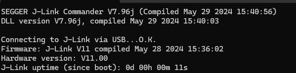

    We need to modify the DLM of our RA6M5 from CM to SSD. We have a J-Link Base and a J-Link-OB-S124 of the EK-RA6M5. With the J-Link-OB-S124 we are capables of do it, but with the J-Link Base we are not. Is there any difference between both? From Renesas support they indicates us, that with the J-Trace Pro that they have, they can modify this register.
    Could you indicate us if with the J-Link Base is possible to do it? Or we have to get any other option available?
    We have read from Segger documentation that with a Segger Flasher this could be done also.

    I am assuming that you use the DLM tools in e2studio for this, correct?
    In general, it should work with any current J-Link model.
    Can you please tell us what J-Link Commander outputs at “Firmware: xxx” for your J-Link BASE?
    Just to make sure that the J-Link in question is not too old.
    Thank you for the answer and sorry for the delay to give you the data (summer holidays....)
    Yes we use e2studio for that.
    This is the info form J-Link Commander:
