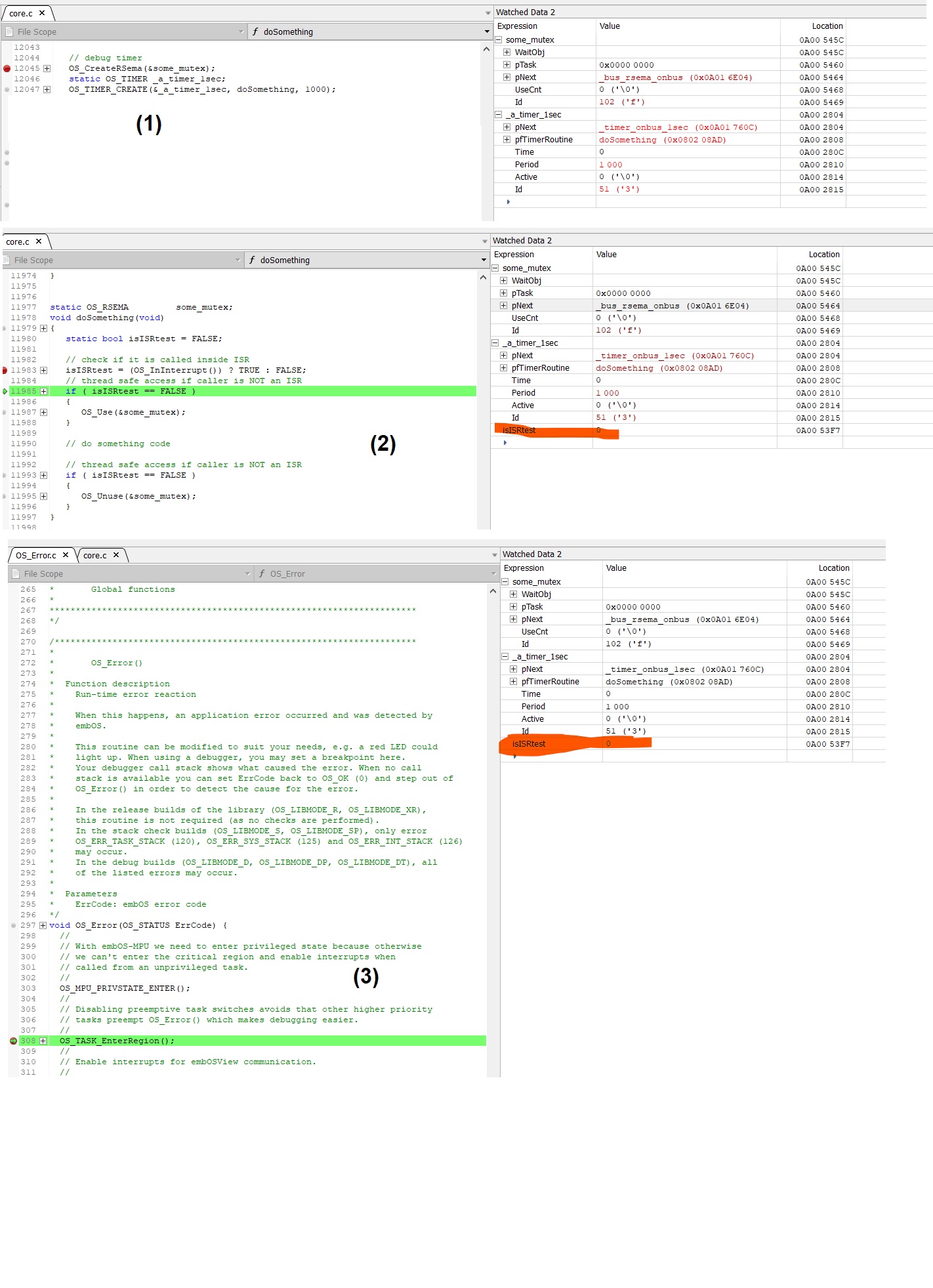

    We have a function that uses mutex, and it is used inside tasks and in ISR function.
    In order to avoid OS error, mutex usage is under condition, checking if caller is in task execution or in ISR exection, using API OS_InInterrupt()
    See example code below
    1. void doSomething(void)
    2. {

    This solution works fine and as expected from embos documentation for API OS_InInterrupt() in both scenarios
    BUT, instead, if the same function is used as callback for a timer SW (where caller is OS code that is called in OS sysTick ISR), API OS_InInterrupt() return WRONG value (it returns "NO isr"),
    so our code goes in OS_error function for invalid usage of OS API inside an ISR
    I didn't see any other way for our code to understand if caller is task code or SW timer, so i think this is an API bug
    Attached screenshot from debugging:
    (1) timer with callback and mutex create
    (2) debug inside function called by SW timer, where isISRtest from OS_InInterrupt() is showed with wrong value
    (3) after this, mutex function is called and code goes in OS_error
    The post was edited 2 times, last by pbizzarri ().
    This is not an embOS bug, but it works as intended.
    OS_INT_InInterrupt() returns 1 only when called from an embOS interrupt routine.
    From any other context, like embOS software timer, it returns 0.
    With Cortex-M embOS software timers are executed within the PendSV() (not SysTick) interrupt, but that is just an implementation detail for embOS Cortex-M.
    From the embOS perspective, it is the software timer context, and you must not use any mutex API within an embOS software timer.
    You could use OS_TIMER_GetCurrent() to check whether a timer callback is currently being executed.
    Does that answer your question?

  • Hi, thanks for quick reply
    Your explanation is very clear, and also help us in undertstanding better where OS timer SW are called ("Cortex-M embOS software timers are executed within the PendSV()")
    Your workaround seems works fine in my tests.
    I defined a macro like this:
    // check OS SW timer context
    #define OS_IS_SW_TIMER_CONTEXT() ((NULL != OS_TIMER_GetCurrent()) ? 1:0)
    and now our code tests both conditions using (OS_InInterrupt() || OS_IS_SW_TIMER_CONTEXT() )
    Let me suggest to add this macro or something similar also in EMBOS macros.
