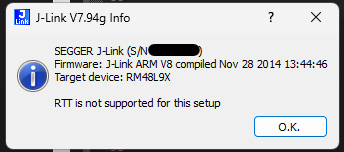

      We are developing a product with TI's RM48 processor familiy and one of the requisites is to have RTT working for debugging purposes.
      We found a couple of forum posts with a lot of useful information on how to approach the problem:
      - [SOLVED] How to setup JLink for background memory access of RM48L952 for real-time terminal?
      - [ABANDONED] SystemView on TI RM48L952
      Unfortunately, every time we try to start an RTT session we get this generic error.
      We are using TI's Code Composer Studio but we'll move to IAR in the near future.
      Here are some more info about our setup:
      Process: C:\Program Files\SEGGER\JLink_V794i\JLinkRTTViewer.exe
      Module: C:\Program Files\SEGGER\JLink_V794i\JLink_x64.dll
      Version: V7.94i, compiled Feb 7 2024 17:08:52
      J-Link: SEGGER J-Link V8.0, SN=(REDACTED)
      J-Link Uptime: N/A (Not supported by this model)
      Selected device: Debugger: RM48L9X, Internal: RM48L9X
      Endian: Little
      Voltage: 3.28 V
      Target interface: JTAG (1000 kHz)
      Host interface: USB (SN REDACTED)
      For what we can see in the Wiki, all JLink models should support RTT (at least in stop mode) so we excluded the hardware incompatibility.
      What could be the cause of this error?
      Also, referring to this thread would it be possible to also have the JlinkScript used internally for the RM48 family?
      Thank you in advance for the support!

      1. LOG: J-Link RTT Viewer V7.94i: Logging started.
      2. LOG: Terminal 0 added.
      3. LOG: Connecting to J-Link via USB...
      4. LOG: Device "RM48L9X" selected.
      5. LOG: ConfigTargetSettings() start
      6. LOG: ConfigTargetSettings() end - Took 8us
      7. LOG: InitTarget() start
      8. LOG: TotalIRLen = 6, IRPrint = 0x01
      9. LOG: JTAG chain detection found 1 devices:
      10. LOG: #0 Id: 0x4B8A002F, IRLen: 06, TI ICEPick
      11. LOG: InitTarget() end - Took 141ms
      12. LOG: TotalIRLen = 10, IRPrint = 0x0011
      13. LOG: JTAG chain detection found 2 devices:
      14. LOG: #0 Id: 0x4BA00477, IRLen: 04, CoreSight JTAG-DP
      15. LOG: #1 Id: 0x4B8A002F, IRLen: 06, TI ICEPick
      16. LOG: DPv0 detected
      17. LOG: CoreSight SoC-400 or earlier
      18. LOG: AP map detection skipped. Manually configured AP map found.
      19. LOG: AP[0]: AHB-AP (IDR: Not set)
      20. LOG: AP[1]: APB-AP (IDR: Not set)
      21. LOG: AP[2]: MEM-AP (IDR: Not set)
      22. LOG: Using preconfigured AP[1] as APB-AP
      23. LOG: AP[1]: APB-AP found
      24. LOG: ROMTbl[0][0]: CompAddr: 80001000 CID: B105900D, PID: 007BBC14 Cortex-R4
      25. LOG: Found Cortex-R4 r1p3
      26. LOG: 6 code breakpoints, 2 data breakpoints
      27. LOG: Debug architecture ARMv7.0
      28. LOG: Data endian: little
      29. LOG: Main ID register: 0x411FC143
      30. LOG: TCM Type register: 0x00010001
      31. LOG: MPU Type register: 0x00000C00
      32. LOG: System control register:
      33. LOG: Instruction endian: little
      34. LOG: Level-1 instruction cache disabled
      35. LOG: Level-1 data cache disabled
      36. LOG: MPU disabled
      37. LOG: Branch prediction enabled
      38. LOG: SetupTarget() start
      39. LOG: Executing SetupTarget()
      40. LOG: Memory access: CPU temp. halted: https://wiki.segger.com/Memory_accesses#Legacy_stop_mode
      41. LOG: SetupTarget() end - Took 18.6ms
      42. LOG: RTT Viewer connected.

    • While RTT Stop-Mode in general might be working for the J-Link you use, stop-mode support on the RM48 may require further features that are specifically needed for RTT on RM48 in general, but these are not provided by the J-Link in use.
      In general, the J-Link you use is a V8 model which is pretty likely 10+ years old and has been out of support and maintenance, so there is no support, bugfixing or even analysis done on it.
      If the same issue comes up with a current model, we recommend to open an official support case and we will take care.
