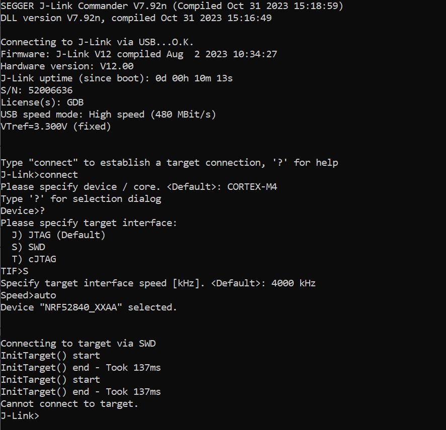

    CONNECTING MY TARGET BOARD TO THE J-Link:
    - If I connect only VREF and GND from the Target connector to my target board, the board is powered and it starts working. I had seen somewhere that VREF didn't power the target board, but it's powering because the board is working fine.
    - If then I connect SWDIO and SWDCLK, Visual Studio Code detects the J-Link but not the target board (see VSCJlink.jpg). Notice the message "Cannot read properties of undefined (reading "find").
    - If I try to connect to the target board from J-Link Commander, see JLC.jpg
    I would appreciate any help, cause right now I just can't assure the JLink debugger is not failing.

  • Is your nRF chip running at 3.3V?
    I am wondering that you connect VTref from the target to J-Link, while at the same time having J-Link configured for fixed VTref 3.3V.
    The only purpose for the „fixed VTref“ setting is to omit the VTref pin…
    Cannot really comment on the VSCode error,
    as this comes from either VSCode or rhe debug plugin, which are both not maintained by SEGGER.
    Considering that things work if you use a DK from Nordic in „debug out“ mode, I suspect a wiring issue when trying with the stand-alone J-Link V12, as even the very low-level SWD communication in J-Link Commander fails…
  • Hi Alex:
    As you said, I had a problem with wiring (I misunderstood the Target connector pinout). Now everything is working fine and I can debug from VSC. Additionally, I have had to power my custom board with an external power supply (I thought the JLink could power the terget board).
    Thank you for your help,
    David.
