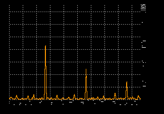

      in a GRAPH widget I want to display a scale in the border area.
      I have added 10 pixels border on the right and on the bottom side.
      In these border areas frequently appear random pixels. Did I miss something in my initialization?

    • Hello Jan,
      Which device are you using and which emWin driver?
      It looks a bit like as if the data where not entirely written into the framebuffer but reside in the CPU cache.
      For example, on STM32 devices devices we call SCB_CleanInvalidateDCache() before any DMA2D operation to ensure the data is properly written into the RAM.
      Sven
