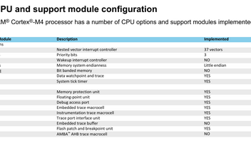

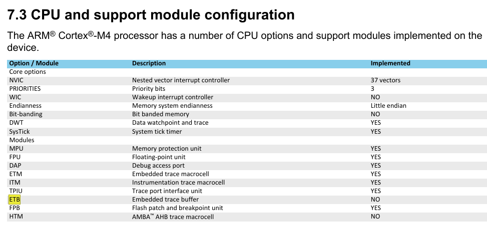

    To be honest, I still don't know if I have the right requirement for tracing and can't really figure out its usecase. I think I need to inform myself what tracing is and if I can utilize its potential.
    Coming to ETB, I am afraid my chip doesn't support ETB. (pls see attachment).
    In this case I guess I need to rely only on software tracing.
    One of the child links from your link talks about trace with RAM functions. Perhaps this what you are refrerring to when you meant software tracing?

    In case your chip does not support ETB, this feature is not available to you. Which device are you working on? It is quite likely that ETM is supported by your device, this would allow you to make use of pin tracing, but also requires you to utilize a J-Trace probe.
