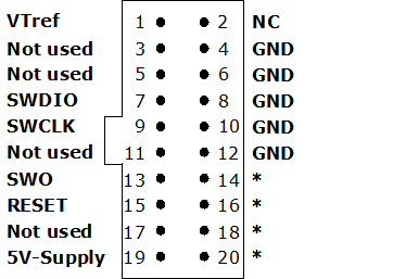

    Can I power the board I am using (PineTime DK) from the Segger JLink Plus compact? I have the VTref connected to where the ST-Link V2 3.3v connector was. In that case it provided power and I'm not sure if I can configure the jlkink plus to supply the power.

    This is the target reference voltage. It is used to check if the target has power, to create the logic-level reference for the input comparators and to control the output logic levels to the target. It is normally fed from Vdd of the target board and must not have a series resistor
  • If your target works with 5V and consumes less than 300mA, you can power it via pin 19 of J-Link.
    Supply specs:
    segger.com/products/debug-prob…#technical-specifications
    see "Target supply voltage" and "Target supply current".
    How to enable the 5V output on pin 19:
    wiki.segger.com/UM08001_J-Link…Guide#Target_power_supply
  • If you have an < 5V board, you need an adapter between J-Link and board if the board should be powered through J-Link:
    segger.com/products/debug-prob…rs/target-supply-adapter/

  • I have 4 connections on the board SWCIO, SWCLK, VCC, and GND. I currently use the ST-Link V2 which has all 4 pins, one of which is a 3.3v and supplies power to the board. I am trying to do the same with the jlink. If I move the VCC to the vtref from the 3.3v Adaptor pin (19) on the JLink where it is currently connected, the board will not have power. I did this previously and the board did not work. I have tried both:
    SWCIO (7), SWCLK (9), VCC (1 - Vtref), GND (4)
    SWCIO (7), SWCLK (9), VCC (19 - 3.3v), GND (4)
    Neither works.
  • Pin 19 of J-Link is a 5V output.
    This needs to be converted to 3.3V for your target as supply voltage.
    At the same time, J-Link needs the target reference(!) voltage on pin 1 for its level shifters. This pin is an input to J-Link.
    You cannot power your target through pin 1.
  • You can connect pin 1 to the 3.3V output of the adapter.
    Alternatively, you do not connect pin 1 at all but use this:
    wiki.segger.com/J-Link_Commander#VTREF
    and use the value “3300”
