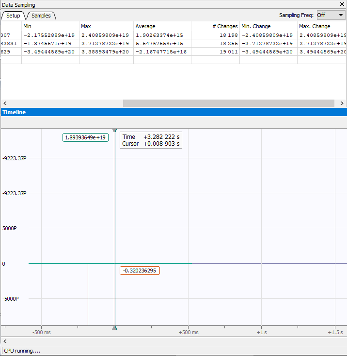

2./11. another example of the zoom problem. I still cannot tell you how to reproduce it. maybe use ozone longer than just for a quick test?
And more: Data and Power, or the time grid, may not be in sync after starting a session with sampling on
edit: I think the problem here, maybe also in other cases, is the scrollbar on the timeline. when it's present, the grids won't line up anymore.
Also notice how the timeline is not starting at 0s, but with the time of the first datapoint of the last run
