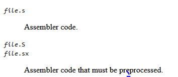

  • In the meantime, I found the bug by myself.
    I renamed the assembler file from SEGGER_RTT_ASM_ARMv7M.S to SEGGER_RTT_ASM_ARMv7M.s, because all of my assembler files (e.g. startup ...) has a lowercase "s" ending.
    The GNU GCC assembler interprets this as a normal assembler file but SEGGER_RTT_ASM_ARMv7M contains assembler code which must be pre-processed and therefore it is notated as a upercase "S" !
    Looking into the GNU GCC documentation, there is a description how the assembler interprets files with ".s" and ".S" endings.
    So, if I leave the file unchanged with the uppercase ending ".S", the assembler builds the file with no errors
    Your analysis is correct. That is why we ship the file with the .S ending, so the file runs first through a preprocessor so it is compatible to different assembler syntaxes from different tool chains.
