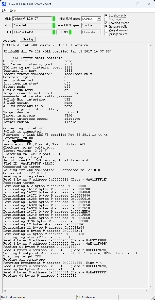

    I'm trying to replicate through a JLink Commander script (for prod automation purposes), what works 100% of the time when using IDEs such Embedded Studio and using the *exact same* setup (attached output from the GDB server).
    I simply need to flash the very same binary produced by the IDEs, into an LPC2294 target, and verify that the flashing succeeded, but I cannot figure out why the verification (or the flashing itself) fails (see setup & details below).
    I appreciate any help on what I may be missing here, thanks!
  • Can you please post a screenshot that also includes the S/N of the J-Link?
    You can also sent it via PM if you are feeling uncomfortable, posting it publicly, for any reason.
  • I have read your PM but you did not actually send the S/N but instead referred to a support ticket, which is a duplicate of this thread.
    We have told you that the unit you are using is an OEM unit from 2009 which is out of support and maintenance.
