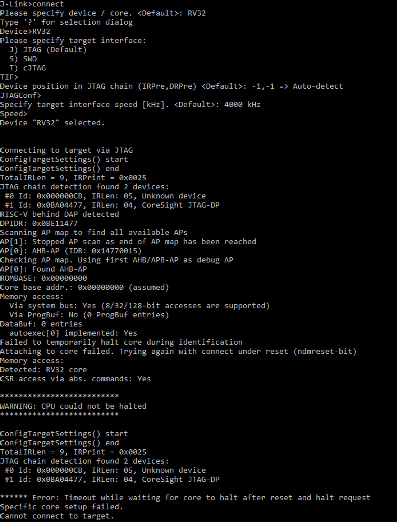

    We are trying to use J-Link as a Debug probe for the RISC-V-based 32-bit Ibex core, but are unable to connect it through J-Link. I am attaching a screenshot for better clarity. Can anyone please help us with that?
    We tried device types as RISC-V, RV32, and RV64 but got the error as per snap.
    Thank you.

  • Sounds like your core is in some uncooperative state where it does not respond to debug commands.
    This is usually caused by an application being executed by the core that enters certain low power states or that performs an illegal memory access that never completes and blocks the core + bus.
    I recommend to check for options to inhibit booting of your application code and then check if a debug connection can be established.

  • Is it possible that you have a setup like this?
    wiki.segger.com/J-Link_RISC-V#RISC-V_behind_a_CoreSight_DAP
    If yes, you need to tell J-Link, where in the CoreSight address space it finds the core, as there is no auto-detection like for Cortex-M / Cortex-A cores.
    See wiki article for more information and examples.
  • Hi Alex
    Yes, our setup is something like this. We are having two cores: RV32 and Cortex-M33 hooked through the JTAG chain. We did change the Core base address for RV32 but still seeing the same error. Is it possible to get an example J-Link script for this configuration?

    Actually, there is an example in the wiki, that shows you what variables to set.
    To which values they need to be set, depends on your setup and you know that better as we do.
    Unfortunately, I cannot share any real-world examples with you because all scripts we did so far for such setups are for customer SoCs which are under NDA.
    What I can tell you is that 0xA for the "core base address" sounds odd. It has to be some 4 KB aligned address.

  • Sorry for the delay.
    It looks like we have misread your setup.
    We guessed that your ARM core + RISC-V core are both accessible through the DAP TAP (IRLen = 4).
    But it seems that in your case there are 2 TAPs:
    1 for the DAP TAP to access the ARM core
    1 for the RISC-V TAP
    If this is the case then yes, indeed you need to provide a known IDCODE for that RISC-V TAP to J-Link.
    Good to hear that you are up and running.
