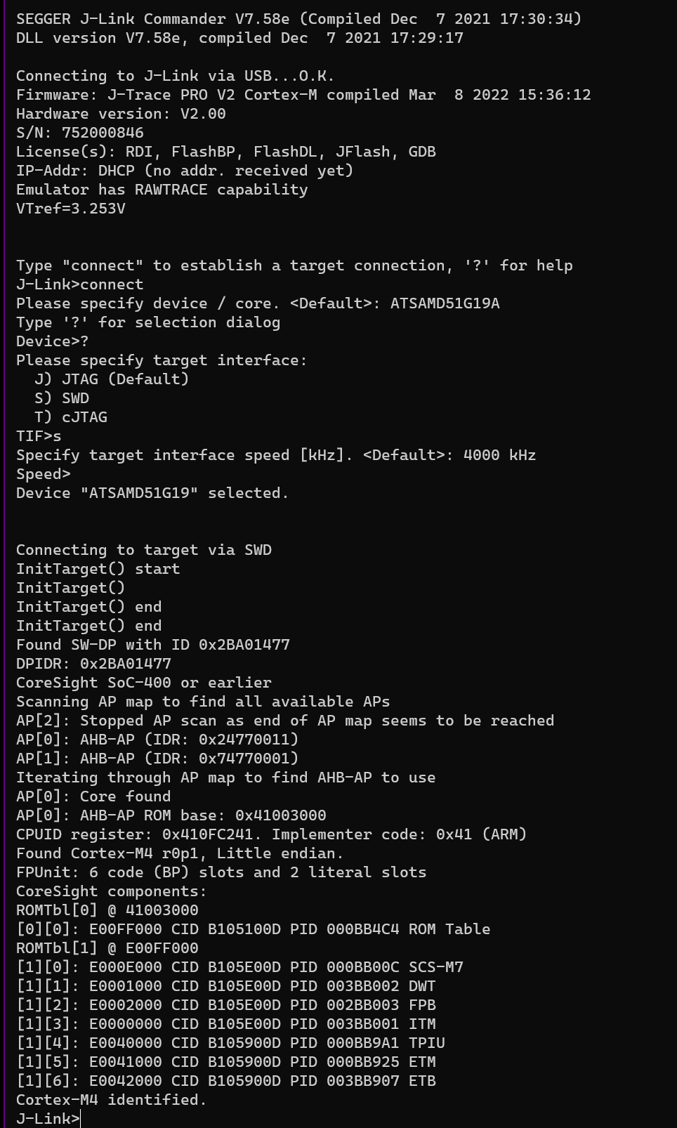

    I upgraded my system and now I cant access to the device. The device isn't connected with the tracer.
    Connect with jlink and JTAG is possible.
    In microchip I want reach the probe with TCP and therefore I added it under "Add Target".
    The device status is "connected".
    If I want to connect, the message is: Unable to connect to tool J-Link over IP (752000846)
    @EDIT
    In microchip under "Device Programming" is a JLink Button and this button appears after selcting Jlink probe but the button is disabled.

    Could you try connecting to J-Trace Pro and your target device with the J-Link Commander via USB first?
    wiki.segger.com/J-Link_cannot_…ty_using_J-Link_Commander
    Does this work?
    If yes, could you try the same via IP?
    Does this work?
    Could you provide screenshots of both connect sessions?

  • Yes, it works. See the atteched output. The probe is not shown in Microchip Studio 7.0.2542
    The subject of this thread is a little bit missleading. I want access the probe from Microchip Studio under Win11.
    Regarding your second test. I dont know how it is possible to attach the probe with Jlink Commander via TCP.
    Microchip Studio is not listed on the “supported IDEs” page and untested.
    Therefore, we cannot guarantee that it works.
    As J-Link Commander is able to detect the J-Link, the USB connection is fine.
    We recommend to contact Microchip regarding this. This is actually the wrong forum at this point.
    We MAY list Microchip Studio in the future though
