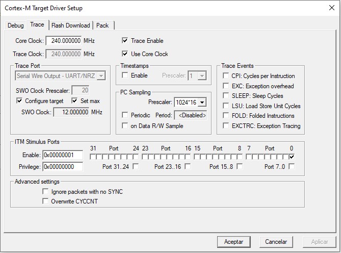

    Good afternoon,
    I'm trying to use the SWO - Printf functionality with a JLINK EDU and the STM32H735VGT MCU, but I don't know what's missing to make it work.
    I think it is something related to the configuration, because I have used the same board and MCU with a STLINK2, and the SWO + printf works correctly.
    Attached is a screenshot of the STLINK2 and JLINK configuration in the IDE.
    IDE: Keil MDK 5.36
    JLINK EDU FW: J-Link V10 compiled Nov 2 2021 12:14:50
    DLL: V7.62
    Thanks for your time.

    Enabling SWO on the H7 series is unfortunately chip specific, so currently for the H73x series the SWO init in J-Link software is missing.
    We will see if it can be added via software update.
    Which eval board are you using currently?

    Yes it will be provided via software update soon.
    To get notified when it is available you can subscribe here:
    segger.com/notification/subscribe.php?prodid=7
