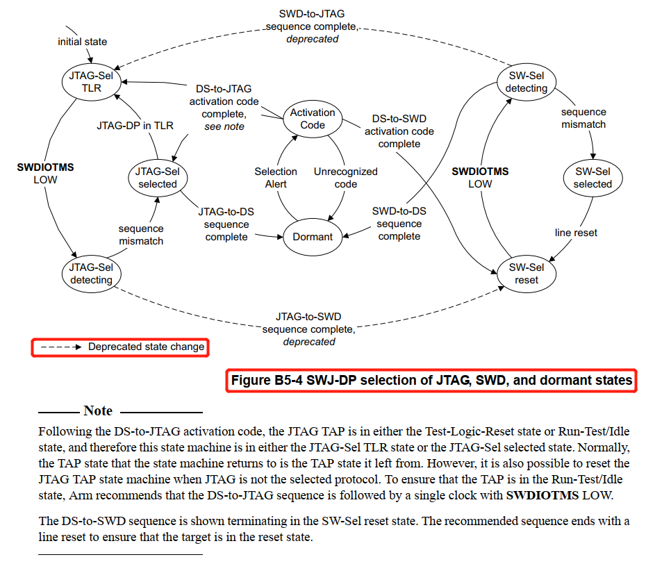

My chip can't switch from JTAG to SWD by using the SWD command of j-link commander v6.98c. The reason is that the chip only supports the mode of dormant operation (Figure B5-4), but doesn't support the mode of 0x79e7 (Figure B5-1). Doesn't JLINK support the mode of dormant now? Or how can I use JLINK to switch my chip from JTAG to SWD。

1. Switching method of b5-1 mode
2. Switching method of B5-4 mode
The above screenshot is from the file:debug_interface_v6_0_architecture_specification_IHI0074C.pdf
