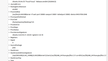

  • Good day and thanks for reply!
    I am sure that you will be able to re-create issue since I also tried with another freshly installed VM with same OS and drivers. Anyway I'm ready to prepare another VM instance (more compact than my usual ones) for you once again by first request.
    Also I tested latest drivers named V6.98b - problem still present. I am attaching screenshots of system error report -maybe they will be useful in tracking issue.

  • Also tested with latest release V720a:
    • Removed all installed JLink by executing sudo apt-get purge --auto-remove jlink
    • Download and installed JLink_Linux_V720a_x86_64.deb
    • Run VSCode and hit F5
    • "buffer overflow detected" error (check the attached screenshot)

    After executing the "purge" with "auto-remove" I can reproduce the issue.
    However, I can only reproduce it when starting a session from within VSCode.
    If I start JLinkGDBServer stand-alone but with exactly the same command line as VSCode uses, I *never* get a fault:

  • OK, found it.
    It actually is not really a buffer overflow but glibc seems to detect it as one.
    Fact 1) If you remove libncurses5 from your system as part of autoremove, you make your GDB toolchain half-way unusable because arm-none-eabi-gdb depends on it. As this is a portable and non-installed package, the package manager does not detect that libncurses5 is still "needed".
    Fact 2) By forcing fact 1, you trigger the following behavior of VSCode:
    • Start GDBServer
    • Try to start GDB which should then open the ELF file and connect to GDBServer
    Starting of GDB fails because of the missing dependency.
    VSCode sends a kill request to GDBServer.
    And there is the bug:
    GDBServer has a race condition on close so that it can happen that it calls a socket operation with an invalid socket handle.

  • Good day, SEGGER team.
    Yes, I can confirm that after clear installation of V698c debug is not available but after installing libncurses5 all functionality fully restored.
    So, for the Ivan and future users here some workaround:
    1. Fully remove all installed previously JLink and dependencies by executing:
    2. Install required JLink version downloaded from dedicated page (according to my tests affected versions are from 6.98a to 7.20a)
    3. Additionally install libncurses5 by executing following command
    sudo apt-get install libncurses5
    and debugging back in place.
    Thank you Alex for deep dive in the issue!
