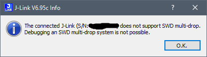

  • What J-Link versions will work with the RP2040?
    I have a J-Link Edu mini, is it Ok? If not, the J-Link Edu? Are there hw versions to take care of on new purchase?
    The Embedded Studio will support the RP2040 too?
    (EDU Mini V1) => Need to check that internally. Not sure about multi-drop being supported.
    EDU / BASE / PLUS V11
    ULTRA+ / PRO V5
    J-Trace PRO Cortex / CortexM V2
    Everything else is out of support and not guaranteed to work.

  • So the mini is not good for the job. Thank you for testing n1kt0.
    How do I know the version of the J-Link Edu? Distributors like Farnell and RS-Online mark them as 8.08.90. Not sure what that means. The manual simply enumerates all the possible products. I think that a clear version number is mandatory, isn't it?
  • @n1kt0:
    For the EDU Mini it is a bug that will be corrected. It is still under maintenance and shall support the RP2040.
    @misha:
    You misunderstood me. I never wrote that the V4 do not support multi-drop. But just because they do, does not mean that they support a brand new device. You cannot expect that a probe that came out years ago supports every brand new device that comes out today or tomorrow.
    Just because a 10 year old probe supports JTAG as a protocol does not mean it supports all current devices that use the JTAG protocol.
    We will update the wiki but my statement stays the same. No guarantee for any other version than the ones I mentioned.
  • EDU Mini:
    SWD multi-drop will be supported in today's release (V6.96).
    Planned to be available in about 4-6 hours from now.
