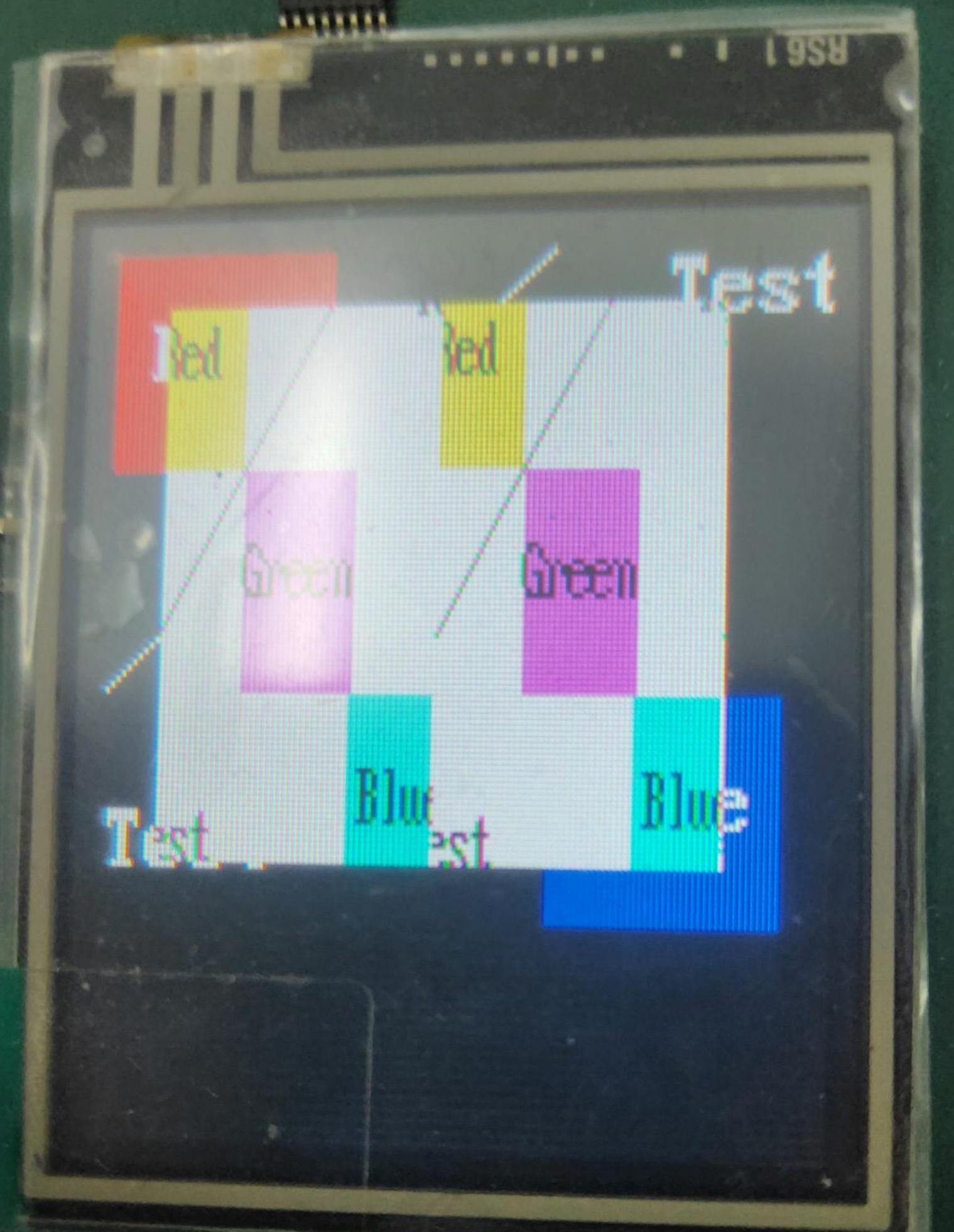

      Please try the code below. It draws a test pattern on the display.

      Can you send me a photo of the output?
      Sven

      I tried your code and it gave the result. The screen size is 128*160

      The test screen looks almost good. See attached on how it should look like.
      After drawing the red, green and blue rectangles and the strings a large rectangle gets drawn with invert mode. If this is not being displayed properly it is most likely that the read function is not working right. If it is not possible to read from the display (for what reason ever) it is mandatory to use display cache.
      To invert the colors emWin needs to read the pxel data and write it inverted back to the LCD. With a cache emWin can read from the cache instead of from the LCD.
      To enable the cache simply use a cache mode when setting up hte driver:
      GUIDRV_FlexColor_SetFunc(pDevice, &PortAPI, GUIDRV_FLEXCOLOR_F66709, GUIDRV_FLEXCOLOR_M16C1B8);
      The last parameter indicated whether a cache is used or not. ...C1... says cache on.
      Take a look at the manual for further information:
      segger.com/doc/UM03001_emWin.html#GUIDRV_FlexColor_SetFunc
      Of course, the cache requires memory. For a cache with a size of 128 x 160 pixel and a color depths of 16bpp you would need additional 40960 Bytes.
      Sven

    • Dear Sven,
      I implemented read function and attached to the driver and run the code. It resulted below
      I changed the GUI_RECT Rect = { 0, 0, 49, 49 }; to GUI_RECT Rect = { 0, 0, 39, 39 };. Do you think this is problem with Cache?. I tried inverting color with black and white . They are running good but others are aren't.
