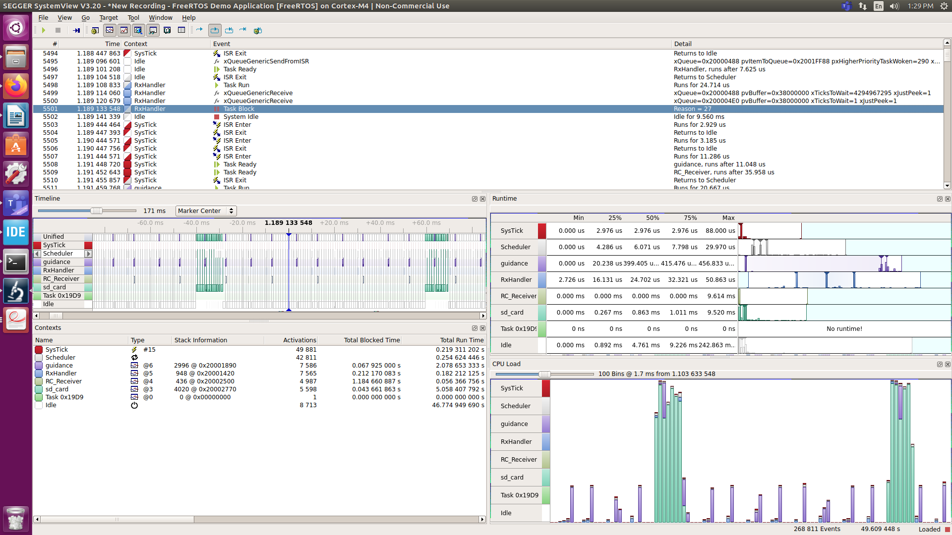

      I'm using segger system view 3.2 on stm32f407 board. I've created 4 task in my application. One thing that I unable to understand is at every context switch I'm getting some value for Reason. I've uploaded a screenshot of it. Can someone please tell me what is the meaning of that reason value and where I can find that list to know more about that different reason value?

      as documented, function SEGGER_SYSVIEW_OnTaskStopReady() holds this information.
      The reason is passed there. All you need to do is to check where the call to this function comes from and what parameter is passed on.
      It is RTOS specific what reason/cause means what. If you debug this you will find that in file SEGGER_SYSVIEW_FreeRTOS.h the following task state defines are used to pass the reason/cause e.g.
      #define traceMOVED_TASK_TO_SUSPENDED_LIST
      This is also by the way reason 27 as you can see from the define. So the task was stopped because it is now suspended. What that means see FreeRTOS documentation.
      To have it resolve to something more readable, you can adjust the RTOS description file in the SystemView install folder under /Description.
      For reference you can see how it is done in SYSVIEW_embOS.txt in line the line starting with TaskState.
      If you do the same for the FreeRTOS file, SystemView will no longer show "Reason xyz" but whatever you have defined here as task states.
      We will update this file for future version of SystemView so the reasons are resolved automatically.
