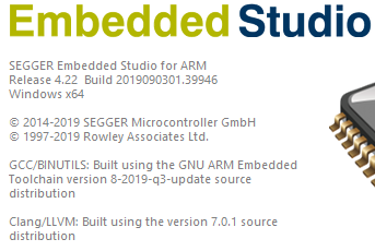

    I am trying to debug a memory corruption issue on a Nordic nRF52832 processor. I have used SES 4.22 and Ozone 3.10e.
    Using SES, I am able to define an expression like this: ((char[480])0x2000486c) && (@pc > 0x47953)
    However this did not work. The issues I see are:
    1. The cast to treat the address as an array of 480 bytes is not working. The breakpoint only triggers when the local variable p_node matches the expression. This is a 2 dimensional byte array [15][32]. The other array locations do not trigger the break.
    2. The @pc portion of the expression is ignored. Both PC and LR are less than 0x4c600
