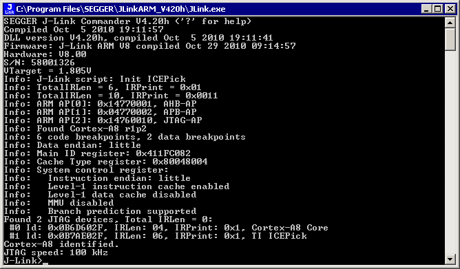

    I have been trying to get JLink working with a Beagleboard-XM (which is a TI DM3730 ARM Cortex-A8 ). I have used a ARM 20 pin to TI-14 pin adapter from Lauterbach.
    I keep seeing the following error returned:

    When I adjust the speed to fixed (2000, 4000, or 6000 kHz), this error goes away but then I can't halt. Doing a reset doesn't solve this either.
    Admittedly I am new to all of this so the fix might be simple! Any help would be really fantastic.

  • Hi Alex,
    the beagle board (to be more specific the OMAP3530 on it) needs a special setup sequence to
    a) put the ARM core into the scan chain (the ICEPick has to be configured)
    and
    b) Assert the DBGEN signal
    This can be done by using a J-Link script file (see chapter 5.10 in UM08001 for more information about script files).
    The J-Link software and documentation package comes with sample script files for different devices.
    They are located at: $JLINK_INST_DIR$\Samples\JLink\Scripts
    In your case, you should copy the ScriptBeagleBoard_OMAP3530.JLinkScript
    to the base directory were the DLL is located and rename it to Default.JLinkScript
    The DLL always checks if there is a Default.JLinkScript file present in the DLL directory,
    to allow the use of script files even if the debugger etc. does not provide a way to configure one.
    Hope it helps.
