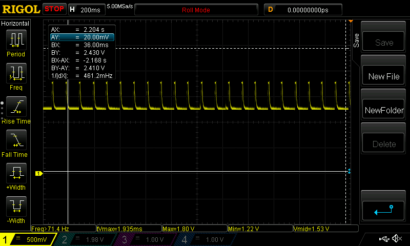

    Result with drag-and-drop:
    Result with scripting:
    Also with our own application after programming:
    Very strange behaviour, it seems to be related with SWD that keeps being active.
