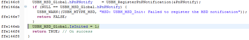

The USBH_MSD_Init() which is called from the OS_USBH_MSD.c sample, successfully registers the PnP notification as shown below.
![](https://forum.segger.com/index.php/Attachment/2595-Attachment-2-png/?s=e3560e98815de59a6f4d66670366de13d5291289)

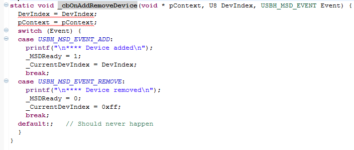

The callback _cbOnAddRemoveDevice in OS_USBH_MSD.c is as below,
![](https://forum.segger.com/index.php/Attachment/2596-Attachment-3-png/?s=e3560e98815de59a6f4d66670366de13d5291289)
But the PnP notification does not occur, and the callback ‘_cbOnAddRemoveDevice’ is never called as there is no PnP notification when a USB stick (Transcend) is connected.
