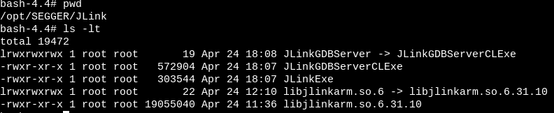

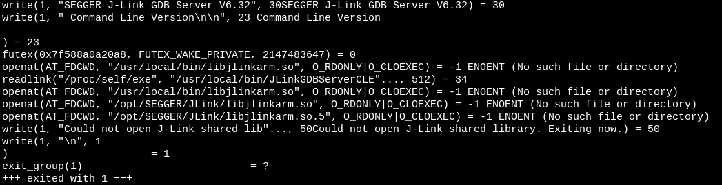

    We are trying to get the JLink-Plus running with GDB for an ARM embedded system under GNU/Linux, but we encountered an unexpected problem.
    The tools and libraries are put into the directories /usr/local/{bin,lib64} as can be seen in the pictures. We followed the documentation (and examples) that is inside the tarball, but for some reason it does not find a (correct) shared library.
    It looks like that JLinkGDBserver is looking at the wrong places and even more strange is that it looks for a library in a "bin" directory ?
    We tried to put a soft link in /opt/SEGGER/JLink/ to the shaed librariy in /usr/local/lib64 but even then it does not find the shared library. A directory "/opt" looks deprecated and therefore we like to avoid such optional directory.
    Is there anything else we need to do to get the JLinkGDBserver going ?
    Thanks in advance !
    Armand

    The J-Link software package for Linux installs the software per default to /opt/SEGGER/JLink/. This is where some of the tools in the package expect the library to be.
    It is currently not supported to link the library from other locations.
    Makse sure your tools and J-Link libs are in the same folder or the library can be found in the opt/SEGGER/JLink folder.

  • Hello Armand,
    That the v5.12 Software is working this way is pure coincidence due to some issues in that version.
    We recommend using the latest software version.
    Currently it is mandatory for the library to be in the same folder as the application.
    We will see if this can be expanded to other folders in future.
    This thread will be treated as solved now as the initial question has been answered.
