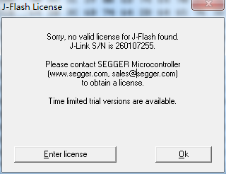

    I just purchased a J-LINK EDU writer, but when I was using J-Flash to flash my ARM board's flash, I suggested that I needed a license. Can't I use J-FLASH for the EDU version? Thank you...

    The J-Link EDU models do not come with a J-Flash license. It needs to be purchased separately or a higher tier J-Link model like J-Link Plus or higher.
    More information can be found here: segger.com/products/debug-prob…nk/models/model-overview/
