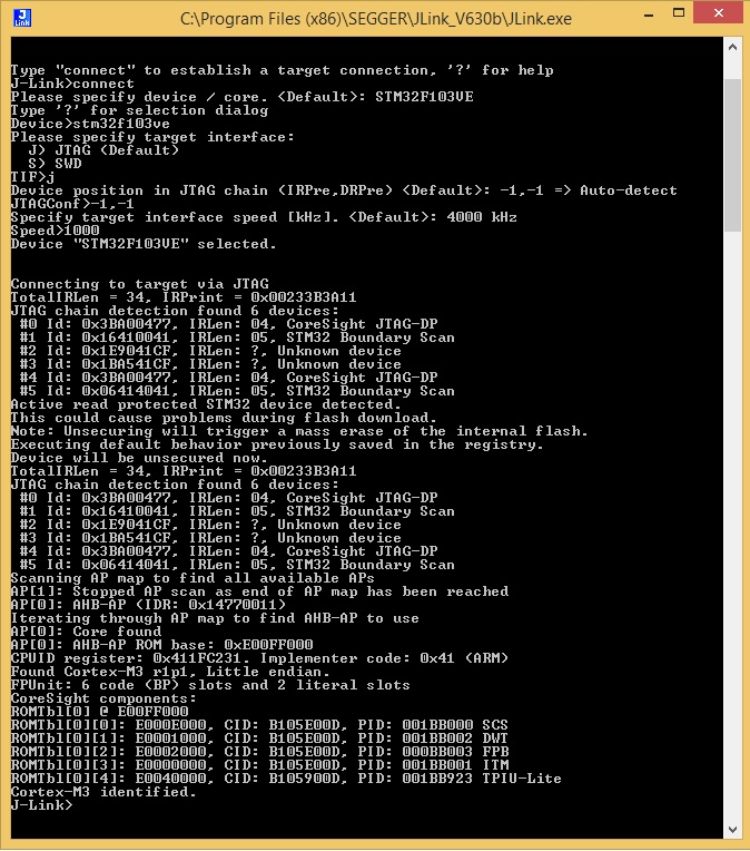

    Greetings!
    I have a device with long JTAG chain (one STM32f103, then two different PLD`s, then other STM32F103).
    I need to program a last one STM32. I used a ULINK2 for this and are trying to move forward to J-Link (Base version).
    You can have a look at the chain in attachments.
    I`m trying to program the controller with KEIL mVision 5.24 + J-Link HW 10.10 and dll 6.30b.
  • Hello Vsevolod,
    The J-Link Commander screen shot you provided shows only the connection to the first STM32 device.
    Could you make a screen shot of the connection to the second STM32 device?
    For this you need to specify the Device position in the JTAG chain.
    In this case IRPre would be 25 and DRPre would be 4.
