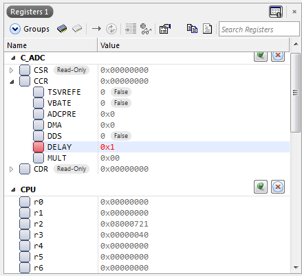

    If i understand you right you want to be able to edit and monitor the MCU's SFR registers through a window like i Keil.
    This is already possible. In ES under View->Registers you can open a Register watch window.
    If you have selected a register description file (e.g. .svd file) for your device you will be able to select multiple registers to show and edit directly.
    Per default only CPU registers are shown. To show other registers as well click on Groups in the Registers window and enable the SFRs that you want to monitor or edit.
    Attached are two pictures that show this feature for a generic STM32407 device generated with the packages from the package manager.

    In the project settings, "none" is specified in the description of the register file (svd). If there is a reference to .svd, the peripheral registers will appear.
    The registers description file (STM32F302x.svd) is specified in the KEIL project settings (<SFDFile> $$ Device: STM32F302C8 $ SVD \ STM32F302x.svd </ SFDFile>). The location of the SVD catalog is also described (<PackID> Keil.STM32F3xx_DFP.1.4.0 </ PackID>). Do I need to enter it with my hands?
    But that's not all.
    I open registers - all-all-all in one small window. Horror. In KEIL for each peripheral device has its own bookmark. In SES - one bookmark and it should be rewound for a long time.
    All? And this is not the end. The data itself is not updated. To do this, click the "refresh" button.
    Tell me, Nino, why do not you love me so much? This is a continuous torment.
    I really want to use SES, but for now I have to be treated for a nervous tic. ((
    Correct.
    You will not be able to use path macros that are defined in Keil. To set the path you can type them in by hand either relative to the project directory or absolute.
    Alternatively simply use the browse function of the projects menu. Attached are two pictures that show the browse button for the register file option.
    You can open up to 4 separate register windows and move them around freely... so i really don't understand what your problem is here...you can also collapse each register group for easier sorting.
    The window is not refreshed constantly, correct. For that simply use the watch feature as discussed before where you can enter different expressions to filter out the registers you want to monitor.
