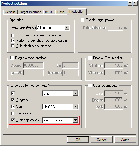

    Hello
    I'm using jlink in IAR and my micro is stm32f030 .
    after i program my micro it won't start working until i reset my micro or using j-Flash->Target->start Application .
    is there any setting that i can do that it happen automatically after programming ?
    Best Regards
    in J-Flash, you can check the "Start application" check-box in the Production tab of the project settings.
    Performing "Auto" (F7) will than also start the microcontroller.
